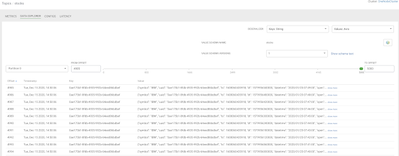

Viewing, Monitoring, Checking and Alerting On Our Streaming Data in Kafka
Cloudera Streams Messaging Manager solves all of these difficult problems from one easy to use pre-integrated UI. It is pre-wired into my Kafka Datahubs and secured with SDX.
I can see my AVRO data with associated stocks schema in the topic, ready to be consumed. I can then monitor who is consuming how much, and if there is a lag or latency.
