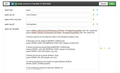

Having run a bunch of Spark jobs locally, in Spark Standalone clusters and in HDP Yarn Clusters; I have found a few JVM settings that helped with debugging non-production jobs and assist with better Garbage Collection. This is important even with off-heap storage and bare metal optimizations.
spark-submit  --driver-java-options "-XX:+PrintGCDetails -XX:+UseG1GC -XX:MaxGCPauseMillis=400"
You can also set options extra options in the runtime environment (see Spark Documentation).
For HDP / Spark, you can add this from Ambari.
