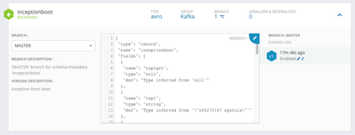

Let's build a schema for this data

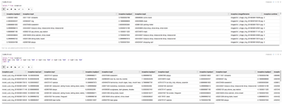

Let's examine the data in Apache Zeppelin

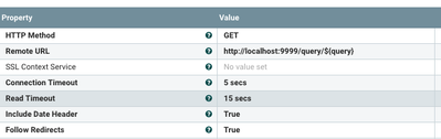

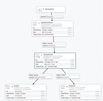

The Main Apache NiFi Flow to Ingest the Spring Boot REST API
Let's use the QueryRecord Processor to Query our Records and only look at ones with a good Top 1 Percent.
Let's look at some Data Provenance

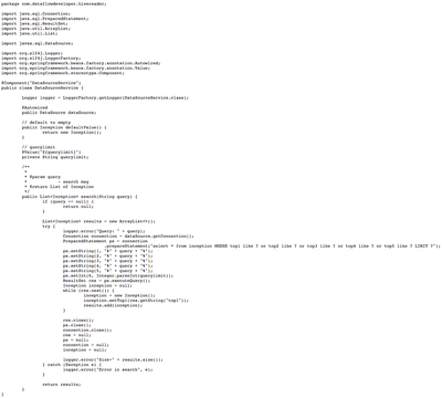

DataSourceService
Get the datasource, the limit to the query and then our one search method. It takes a query parameter received from the REST API and sets that in a few places to query all of our text results and adds the limit. We add that to our handy object and put it in a list. There are tons of helpers and short cuts to make this easier, but this works for me. Close everything up and return this list. Spring Boot returns this as a JSON array of clean data. This is very easy to work with in Apache NiFi. This makes for a nice combination.
