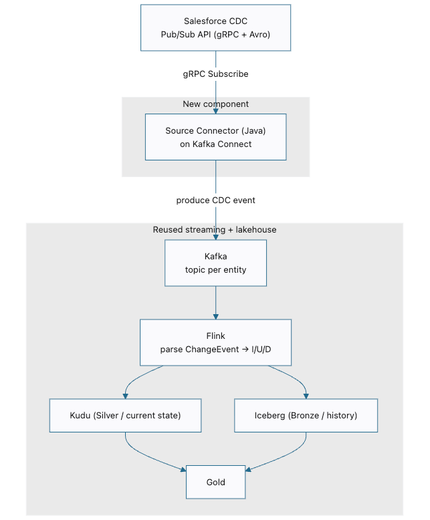

Option D — implement the bridge as a Kafka Connect Source connector — wins for one decisive reason: the framework already solves the hard part. In the Kafka Connect model, a SourceTask.poll() returns records each carrying a sourceOffset. Connect persists that offset automatically to an internal offsets topic and hands it back on restart. So the replayId ↔ offset bookkeeping — the thing you would otherwise write, test, and get subtly wrong — becomes map replayId onto the Connect source offset and let the framework do it.
You also inherit the rest of the Connect operational surface for free:
  • Horizontal scale via tasks. If you must subscribe to many orgs or many channels, Connect distributes tasks across workers. This matters enormously at fan-out (think hundreds of subscriptions).
  • Managed lifecycle, config, and monitoring through the Connect REST API and whatever streaming-management UI your platform ships.
  • Dead-letter handling for poison records without killing the task.

Here is the architecture:

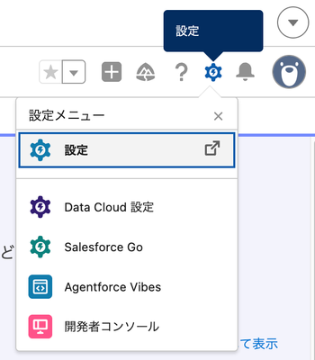

Enable the CDC feature in Salesforce
  • Click the [setup] icon in SFDC menu.

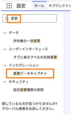

  • Search Change Data Capture / 変更データキャプチャ

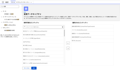

  • Then configure what entity to sync.

Downstream: one CDC paradigm, reused
Once change events are in Kafka, the downstream is not Salesforce-specific anymore — it is just CDC, the same shape you already handle for database sources. A Flink job reads the topic, inspects ChangeEventHeader.changeType, and routes:
  • Silver (current state) — upsert/delete by recordId into a mutable store such as Kudu. This is the "what does the record look like now" table.
  • Bronze (history) — append every event to Iceberg for full audit, replay, and time travel.
  • Gold — modeled, business-ready tables built from Silver/Bronze.

  • The Salesforce Pub/Sub API is gRPC + Avro; you need a bridge to reach Kafka. There is no native connector, and REST polling is not CDC.
  • Implement the bridge as a Kafka Connect Source connector so the framework handles offset persistence, scaling, and lifecycle — map replayId onto the Connect source offset.
  • Design for at-least-once: guarantee no loss via replay, and make the downstream idempotent on (recordId, commitNumber).
  • Keep the raw event in Kafka (and Bronze) so any transform failure is reprocessable, never lost.
  • Settle schema evolution, dead-lettering, JWT auth, and network egress before you write the connector — those, not the gRPC plumbing, are where projects actually stall.
