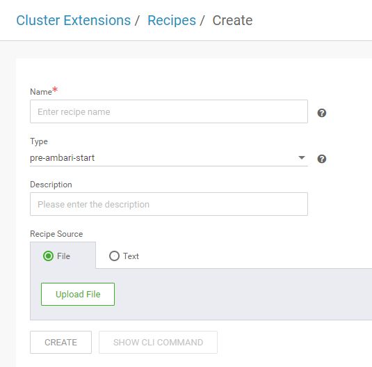

  1. Create a pre-ambari-start recipe to install the mysql-connector-java.jar:
    #!/bin/bash # Provide the JDBC Connector JAR file.
    # During cluster creation, Cloudbreak uses /opts/jdbc-drivers directory
    for the JAR file yum -y localinstall
    https://dev.mysql.com/get/mysql57-community-release-el7-8.noarch.rpm yum -y
    install mysql-connector-java* if [[ ! -d /opt/jdbc-drivers ]]
    then mkdir /opt/jdbc-drivers cp /usr/share/java/mysql-connector-java.jar
    /opt/jdbc-drivers/mysql-connector-java.jar fi

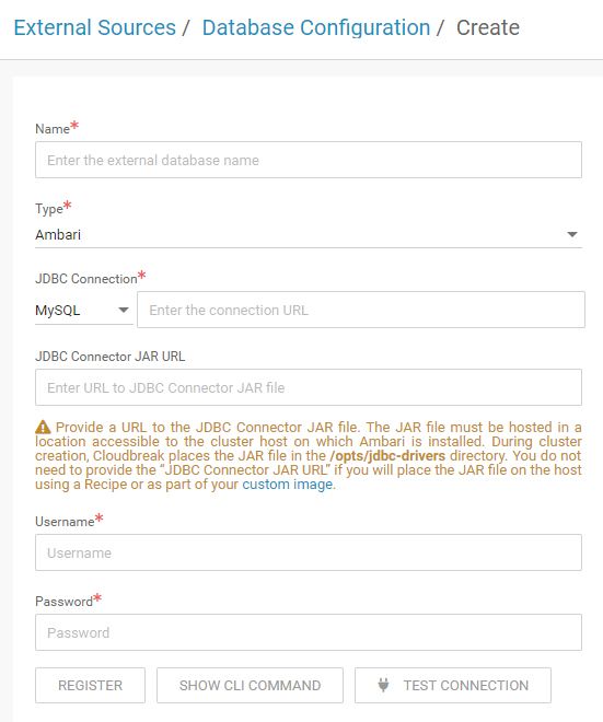

  2. Register the database configuration: Database:
    MySQL MySQL Server: MySQL_DB_IP/FQDN MySQL User:
    ambari MySQL Password: Hadoop1234! JDBC Connector JAR URL:
    Empty JDBC Connection jdbc:mysql://MySQL_DB_IP/FQDN:Port/ambari01
