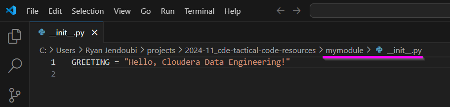

1. Create your Python module
This is the code that we will upload to the CDE Resource, which will ultimately be called from your Airflow Job. For this example, we will literally just define a literal:

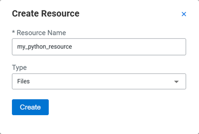

2. Create the Resource in CDE
Go into your CDE Virtual Cluster, and create a new resource.
Note there are different "Types" of resources which can be created, and the public documentation only describes how to create a "Python Environment" type resource (because this is slightly more nuanced). In our case, we are just making a "Files" type resource, which is trivially straightforward.
Note that the Resource Name used here will form part of the actual path from which we will load our code later! I am naming it simply "my_python_resource".

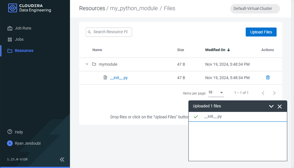

Once the Resource is created, create a "mymodule" subdir inside the resource, and upload our one-line __init__.py within that subdir:

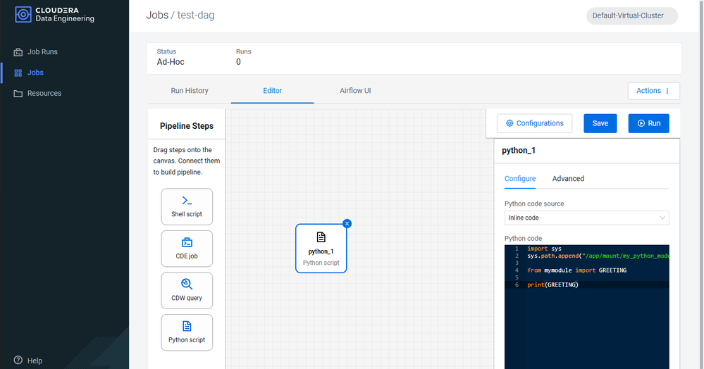

3. Create the Airflow Job in CDE
There are various ways to do this; in this case, I chose to use the Pipeline UI, a visual editor for Airflow DAGs built-in to the CDE interface.
The important thing is that our DAG contains a Python Script operator. This is where the (really basic) "magic" happens: we manipulate our Python path to include the special mount location where we know our Resource files will be available. Once that's done, we can import the variable from our amazing module, and use it 🙂 Here's the code:
import sys
sys.path.append("/app/mount/my_python_module")
from mymodule import GREETING
print(GREETING)
Make sure to hit Save in the Pipeline UI editor, and wait for the success toast:

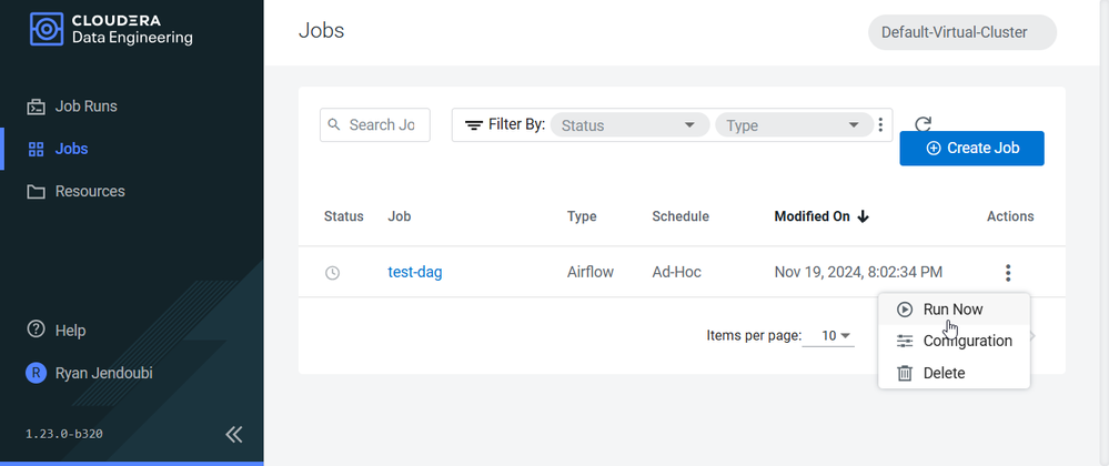

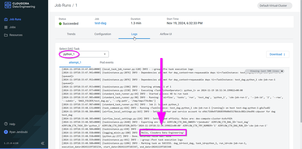

5. Run the Job
Finally, to sample the sweet fruits of our labors, you can go ahead and Run your Airflow Job:
(Feel free to invoke this from the CDE CLI, for extra credit 😉)

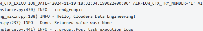

Once the Job completes—which should be a matter of seconds—navigate to the relevant Job Run screen, click across to the Logs tab, and look through the log output...
Success! We see the special message which was defined in our (extremely basic) code module, which we had uploaded into our Resource, not into the DAG itself:
