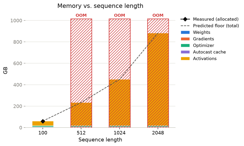

Sequence length is the fastest way to hit the wall (worked model, batch 256, BF16 mixed precision): predicted total demand grows linearly through 236, 452, and 884 GB at seq 512, 1,024, and 2,048 — the last of them eleven cards' worth — for what looks like a modest config change. The hatched bars are configurations that ran out of memory; the black diamond is the one that fit.
That is the pattern worth internalizing. The static line items are set by decisions you have probably already made — model size, optimizer, precision. The dynamic line item is set by decisions you can still change, and it is usually the one that determines what hardware you need.
