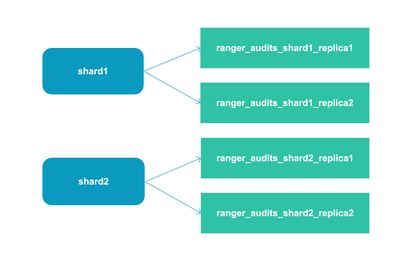

Shard / replica mapping visually: (note that the replicas for one shard are on different hosts)

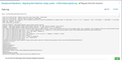

Here, the first and the third commands are the important ones. The first command sends commands to those ambari-agent hosts, where ambari-infra-solr-clients are installed and executes an apt/zypper or yum upgrade against ambari-infra-solr-client packages. With this way you do not need to ssh into every (related) host and upgrade those packages. (if you hit any issue with that command, you can do that as a workaround).
The third command is responsible to send ambari Solr backup commands to ambari-agents where Infra Solr servers are installed. The backup calls are done per hosts / cores where it's required, also that is important to backup only 1 replica from a shard (that is less time + those are the replications anyway, if you need 1 more copy from a shard you can just manually copy the backup to somewhere else).
The backup commands can be done manually as well, but for that you will need to figure out the right core urls + leaders. You can use the state.json output above to figure that out. The solr prefix url for backup command (see: https://lucene.apache.org/solr/guide/6_6/making-and-restoring-backups.html#backup-api) for 1 replica (let's say core_node2), can be created from its "base_url" and "core" (with core_node2 example, that is "http://c7402.ambari.apache.org:8886/solr/ranger_audits_shard1_replica1"), with this knowladge, a manual backup command for 1 shard looks like this (with the manual way, you need this step for every shard):

3. a.) Migrate
Migrate will send ambari commands to hosts where you have snapshots, that will run IndexUpgraderTool (https://lucene.apache.org/solr/guide/6_6/indexupgrader-tool.html) by solrIndexHelper script.
The solrIndexHelper script can be executed manually against the snapshots:
export JAVA_HOME=/usr/jdk64/1.8.0_112
# if /tmp/ranger-backup is your backup location
infra-lucene-index-tool upgrade-index -d /tmp/ranger-backup -f -b -g
# -b flag work as a filter, it will use the snapshot.* folders for index upgrade
# with 'infra-lucene-index-tool help' command you can checkout the command line options
You can also use a java command directly on the index, the lucene libraries can be found at /usr/lib/ambari-infra-solr-client/migrate (both lucene 6 and lucene 7 libraries)
java -cp  /usr/lib/ambari-infra-solr-client/migrate/lucene-backward-codecs-6.6.2.jar:/usr/lib/ambari-infra-solr-client/migrate/lucene-core-6.6.2.jar lucene.index.IndexUpgrader [-delete-prior-commits] [-verbose] /path/to/index
Note that the index upgrade can take a lot of time (1GB/min), so worth to do the migration commands with nohup, in order to run the commands in the background.
In case of someone totally skipped the backup and Infra Solr instances were upgraded, it is still possible to fix the lucene 5 index, by running the IndexUpgrader on you index (but make sure Solr is stopped)

It is possible that your snapshots and the newly created shards will be on different hosts. You can solve this issue by deleting core data from your local filesystem (like in /opt/ambari_infra_solr/data/old_ranger_audits* or where your solr data dir located for that collection...you can safely delete data from there as that collection is empty), and edit the old_ranger_audits state.json (download znode content, then upload it) to use the right hosts for a shard. (you need to replace base_url and node_name values in the state.json). After the state.json update, you will need to restart the Solr instances. Note these hacks are only required if you want to manually copy your index files to the new cores and you should do these only if the Solr Rest API RESTORE actions (https://lucene.apache.org/solr/guide/6_6/making-and-restoring-backups.html#restore-api) did not worked.
For 1 shard using Solr restore command can look like this (core names can be gathered from the state.json - similar as you have seen in the backup phase, but look at the old_ranger_audits collection, not the ranger_audits_collection):
su infra-solr
BACKUP_PATH=... # backup location, e.g.: /tmp/ranger-backup
OLD_BACKUP_COLLECTION_CORE=... # choose a core to restore
BACKUP_CORE_NAME=... # choose a core from backup cores - you can find these names as : <backup_location>/snapshot.$BACKUP_CORE_NAME
kinit -kt /etc/security/keytabs/ambari-infra-solr.service.keytab $(whoami)/$(hostname -f)
curl --negotiate -k -u : "http://c7403.ambari.apache.org:8886/solr/$OLD_BACKUP_COLLECTION_CORE/replication?command=RESTORE&location=$BACKUP_PATH&name=$BACKUP_CORE_NAME"
