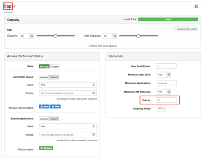

    Root Cause:
    This issue occurs when there is an issue with queue prioritization, where both queues have priority set to 0 which means both are of equal priority. This can be viewed from Ambari > Yarn Queue Manager view.
    The Hive LLAP (Low-Latency Analytical Processing) enables us to run Hive queries with low-latency in near real-time. To ensure low-latency, set the priority of the queue used for LLAP to a higher priority, especially if the cluster includes long-running applications.
    Solution
    To resolve this issue, set the priority of queue LLAP to a higher value higher than the default queue.
    After setting the higher priority, ensure to save and refresh the queues for the change to take effect.
    For YARN Queue Priorities to be applied, enable preemption. To enable preemption, refer to this documentation.
