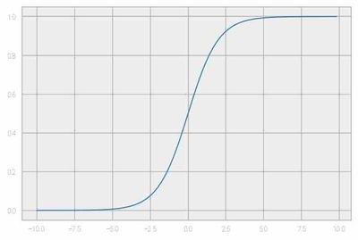

The main reason behind using a sigmoid function as the cost function is that it helps to map predicted values to probabilities that hold the values in the range 0 to 1. Equation used to represent a sigmoid function: 1/1+exp(-x). Plot of sigmoid function is shown as below.

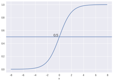

Decision boundary: We expect a logistic regression classifier to produce a set of outputs based on probability when we pass the inputs through a prediction function and it returns a probability score between 0 and 1. For example, if you have two classes—say, tumor and non-tumor samples—the logistic regression model decides on a threshold value, above which we classify values as class 1, and below which we classify as class 2.
Fig 1: Threshold
For example, in the figure above,  0.5 is considered the threshold. If the prediction function returned 0.7, then it is considered as class 1 (tumor). If the prediction function returned 0.2, then it is considered as class 2 (non-tumor).

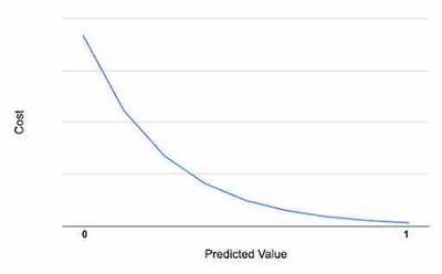

When the true value is 1 and the predicted value(y) is 1, the cost is zero. When the prediction is far away from 1, the cost increases as shown in the above image. In linear algebra, this type of function is represented as:
−log((x)) if y = 1

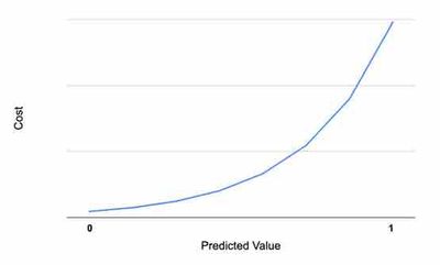

Similarly, when the actual value is 0 and the predicted value is exactly 0, the cost is 0. If the predicted value is moving far from the actual value, the cost increases as shown in the figure below. This type of plot in linear algebra is:
−log(1−hθ(x)) if y = 0
