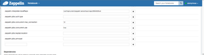

Modify Zeppelin JDBC interpreter
Now we need to modify the existing JDBC interpreter in Zeppelin. By default, this interpreter will work with Hive, Postgres and Phoenix. We will be adding Solr to the configuration.

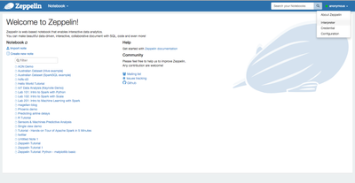

Open the Zeppelin UI. You can either use the link in Ambari or directly via http://localhost:9995. You should see something like this:
Click on the user menu in the upper right. You are logged into Zeppelin as anonymous. You should see a menu like this:

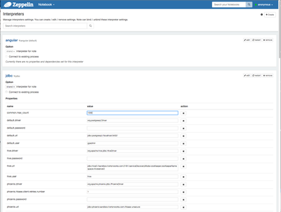

Click on the Interpreter link. You should see something like this:
You should see the jdbc interpreter near the top of the list. If you don't, you can either scroll down or use the build-in search feature at the top of the patch. You should click on the edit button for the jdbc interpreter. You will notice the screen changes to allow you to add new properties or modify existing ones. You should see something like this:
Scroll down until you see the empty entry line. You should see something like this:
We need to add 3 properities/values here.
solr.url jdbc:solr://localhost:9983?collection=gettingstarted
solr.user solr
solr.driver org.apache.solr.client.solrj.io.sql.DriverImpl
Why are we using port 9983? That is because we are in SolrCloud mode. We are pointing to the Zookeeper instance. If one of the nodes goes down, Zookeeper will know and direct us to a node that is working.

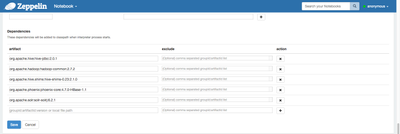

Add each of these properties and click the + button after each entry. You should now have 3 new properties in your list:
Now we need to add an artifact to the Dependencies section. It's just below the properties. We are going to add the following:
org.apache.solr:solr-solrj:6.2.1
Click the + button. You should see something like this:
Now click the blue Save button to save the changes.

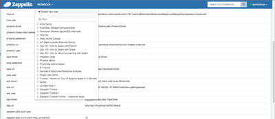

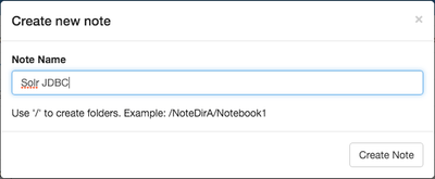

Create a new notebook
Now that we have our JDBC interpreter updated, we are going to create a new notebook. Click the Notebook drop down menu in the upper left. You should see something like this:
Click the + Create a new note link. You should see something like this:
Give the notebook the name Solr JDBC, then click the Create Note button.
We can query Solr using a prefix for jdbc like %jdbc(solr). The prefix refers to the name of the prefix of the properties in the JDBC interpreter we setup. If you recall, there were properties like:
solr.url
phoenix.url
hive.url
psql.url

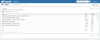

Our prefix is solr. Create the following query as the first note:
%jdbc(solr)
select name, price, inStock from gettingstarted
Now click the run arrow icon. This will run the query against Solr and return results if our configuration is correct. You should see something like this:

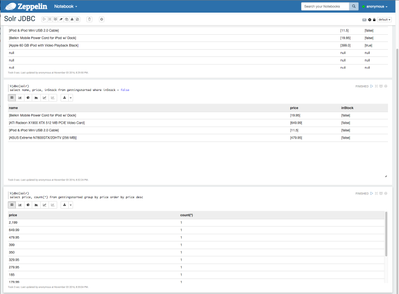

Now add another note below our first one with the following query:
%jdbc(solr)
select name, price, inStock from gettingstarted where inStock = false
And finally add one more note below our second one with the following query:
%jdbc(solr)
select price, count(*) from gettingstarted group by price order by price desc
As you can see it was easy to simple queries and more complex aggregations using pure SQL. For comparison, here is Solr query that does the same thing as our second note:
