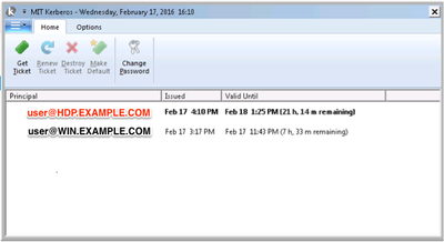

Get Kerberos Ticket using MIT Kerberos Utility
1. Click start button
2. Click All Programs
3. Click Kerberos for windows program group

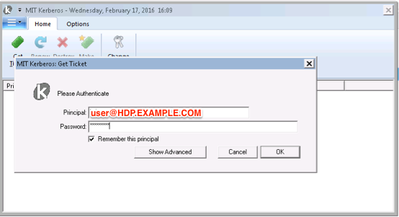

4. Use "MIT Kerberos Ticket Manager" to obtain a ticket for the principal that will be used to connect to HDP cluster.
a. Click Get Ticket
b. Enter Principal and Password as below.

If you don't have a kerberos ticket, then this opens a dialog box for MIT kerberos client requesting Principal and password for the HDP KDC user. ([email protected] and ******).

Remember to refresh the ticket as it expires overtime (using getTicket in the MIT kerberos client utility).
