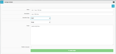

Now click on the green create recipe button. You should see something similar to this:

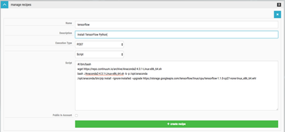

Now we can enter the information for our recipe. I'm calling this recipe tensorflow. I'm giving it the description of Install TensorFlow Python. You can choose to run the script as either pre-install or post-install. I'm choosing to do the install post-install. This means the script will be run after the Ambari installation process has started. So choose the Execution Type of POST. The script is fairly basic. We are going to download the Anaconda install script, then run it in silent mode. Then we'll use the Anaconda version of pip to install TensorFlow. Here is the script:
#!/bin/bash
wget https://repo.continuum.io/archive/Anaconda2-4.3.1-Linux-x86_64.sh
bash ./Anaconda2-4.3.1-Linux-x86_64.sh -b -p /opt/anaconda
/opt/anaconda/bin/pip install --ignore-installed --upgrade https://storage.googleapis.com/tensorflow/linux/cpu/tensorflow-1.1.0-cp27-none-linux_x86_64.whl
You can read more about installing TensorFlow on Anaconda here: TensorFlow Docs.
When you have finished entering all of the information, you should see something similar to this:

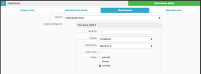

Now that our recipe has been created, we can create a cluster that uses the recipe. Go through the process of creating a cluster up to the Choose Blueprint step. This step is where you select the recipe you want to use. The recipes are not selected by default; you have to select the recipes you wish to use. You can specify recipes for 1 or more host groups. This allows you to run different recipes across different host groups (masters, slaves, etc). You can also select multiple recipes.
We want to use the hdp26-spark-21-cluster blueprint. This will create an HDP 2.6 cluster with Spark 2.1 and Zeppelin. You should have created this blueprint when you followed the prerequisite tutorial. You should see something similar to this:
In our case, we are going to run the tensorflow recipe on every host group. If you intend to use something like TensorFlow across the cluster, you should install it on at least the slave nodes and the client nodes.

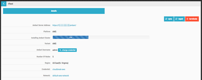

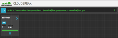

After you have selected the recipe for the host groups, click the Review & Launch button, then launch the cluster. As the cluster is building, you should see a message in the Cloudbreak UI that indicates the recipe is running. When that happens, you will see something similar to this:
If you click on the building cluster, you can see more detailed information. You should see something similar to this:

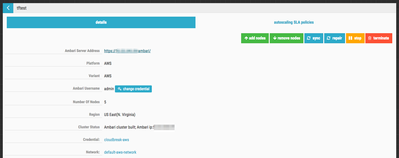

Once the cluster has finished building, you should see something similar to this:

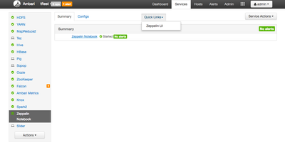

We need to update the default spark2 interpreter configuration in Zeppelin. We need to access the Zeppelin UI from Ambari. You can login to Ambari for the new cluster from the Cloudbreak UI cluster details page. Once you login to Ambari, you can access the Zeppelin UI from the Ambari Quicklink. You should see something similar to this:

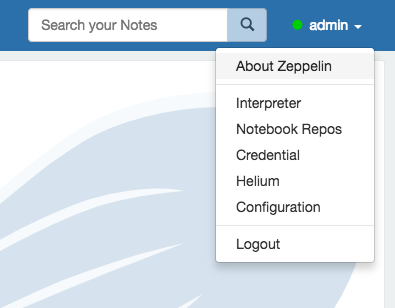

After you access the Zeppelin UI, click the blue login button in the upper right corner of the interface. You can login using the default username and password of admin. After you login to Zeppelin, click the admin button in the upper right corner of the interface. This will expose the options menu. You should see something similar to this:

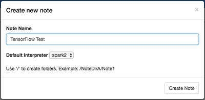

Click on the Create new note link. You can give the notebook any descriptive name you like. Select spark2 as the default interpreter. You should see something similar to this:

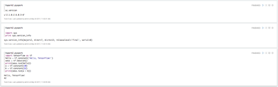

Now we can test TensorFlow. Enter the following in the third paragraph:
%spark2.pyspark
import tensorflow as tf
hello = tf.constant('Hello, TensorFlow!')
sess = tf.Session()
print(sess.run(hello))
a = tf.constant(10)
b = tf.constant(32)
print(sess.run(a + b))
This simple code comes from the TensorFlow website: [TensorFlow] (https://www.tensorflow.org/versions/r0.10/get_started/os_setup#anaconda_installation). Now click the run button for the paragraph. You may see some warning messages the first time you run it, but you should also see the following output:
Hello, TensorFlow!
42
As you can see, TensorFlow is working from Zeppelin which is using Spark 2.1 and Anaconda. If everything works properly, your notebook should look something similar this:
