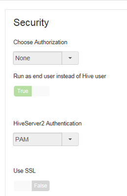

In Ambari switch authentication to PAM hive.server2.authentication = PAM

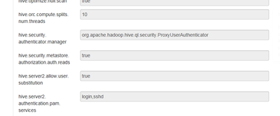

Different possibilities, what worked for me was login, sshd: hive.server2.authentication.pam.services=login,sshd

I setup the Hiverserver2 authentication with PAM using all 1-5 steps but unfortunately still getting invalid login error while using beeline. I used AMD64 JPAM lib.
My hiveserver2 java lib path is:
-Djava.library.path=:/usr/hdp/current/hadoop-client/lib/native/Linux-amd64-64:/usr/hdp/2.3.4.0-3485/hadoop/lib/native
In HDP 2.3, there is no path: /usr/hdp/current/hadoop-client/lib/native/Linux-amd64-64
I copied the .so in /usr/hdp/2.3.4.0-3485/hadoop/lib/native.
