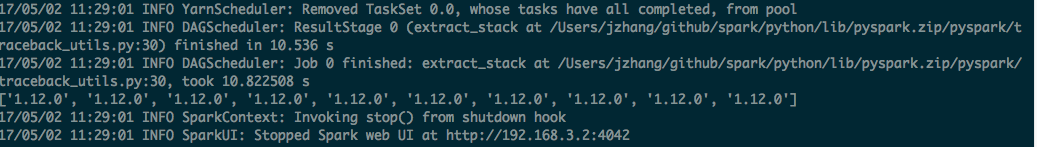

After installing numpy, you can use numpy in PySpark apps launched by spark-submit in your local environment. Use the following command:
bin/spark-submit --master local spark_virtualenv.py

spark-submit --master yarn-client --conf spark.pyspark.virtualenv.enabled=true  --conf spark.pyspark.virtualenv.type=native --conf spark.pyspark.virtualenv.requirements=/Users/jzhang/github/spark/requirements.txt --conf spark.pyspark.virtualenv.bin.path=/Users/jzhang/anaconda/bin/virtualenv --conf spark.pyspark.python=/usr/local/bin/python3 spark_virtualenv.py
You will see the following output, which shows that we have installed numpy on each executor successfully:

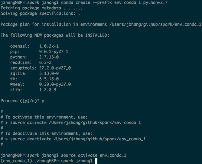

Next, I will talk about how to create a virtual environment using conda. The process is very similar to virtualenv, but uses different commands.
Here is the command to create virtual environment env_conda_1 with Python 2.7 in the local environment. Folder env_conda_1 will be created under the current working directory:
conda create --prefix env_conda_1 python=2.7
Use the following command to activate the virtual environment:.
source activate env_conda_1  // activate this virtual environment
Next, install numpy using the conda install command:
conda install numpy
Use the following command to create the requirements file. This command will put all of the installed Python package info into this file, so keep to stay in this virtual environment you created above.
conda list --export > requirements_conda.txt

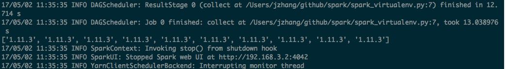

Run the pyspark job in yarn-client mode:
bin/spark-submit --master yarn-client --conf spark.pyspark.virtualenv.enabled=true--conf spark.pyspark.virtualenv.type=conda--conf spark.pyspark.virtualenv.requirements=/Users/jzhang/github/spark/requirements_conda.txt --conf spark.pyspark.virtualenv.bin.path=/Users/jzhang/anaconda/bin/condaspark_virtualenv.py
You will see output similar to the following, which looks the same as the local example:

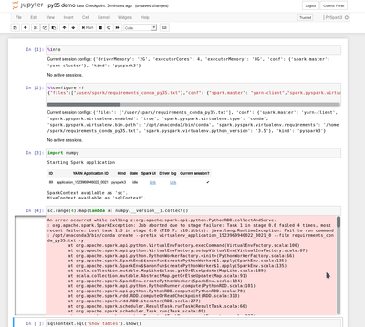

Contributor
is it possible to submit such a spark job via livy . ?
I am trying to subit spark jobs on yarn with a jupyter notebook using spark magic and livy.
getting the following error when trying to activate the virtualevn
java.lang.RuntimeException: Fail to run command: /opt/anaconda3/bin/conda create --prefix virtualenv_application_1523969946022_0021_0 --file requirements_conda_py35.txt -y
