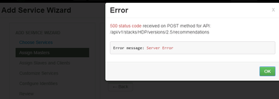

500 status code received on POST method for API: /api/v1/stacks/HDP/versions/2.5/recommendations Error message: Server Error
First of all thanks to all who answer this question as i am struggling with this issue from many hours but unable to resolve it.
I have HDP2.5 running on my dev environment. After making a cleanup of all services except ZooKeeper i am not able to add any service using Ambari UI. The error message is below:-
Error screen shot is also attached for reference.
I have restarted the Ambari-server many times but no success.
Thanks again.

Ambari server log will have detailed exception for this issue. Please check what is the complete exception you see in /var/log/ambari-server/ambari-server.log while you are attempting to add a service.
Most probably this might be due to Ambari DB issues which you can identify from ambari-server.log

i hit the same error and ambari-server.log shows "ERROR [ambari-client-thread-25] HostImpl:1374 - Config inconsistency exists: unknown configType"
