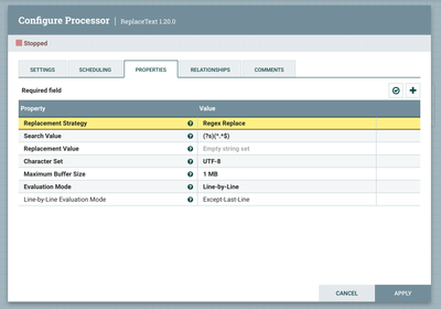

What version of NiFi are you using? In NiFi 1.20.0, you can use ReplaceText Processor after reading in the file.
Using the line-by-line evaluation mode, there is a drop down "Except-Last-Line". You could then configure it to just replace all previous lines with empty strings.
Here's a screenshot of my ReplaceText processor properties.
