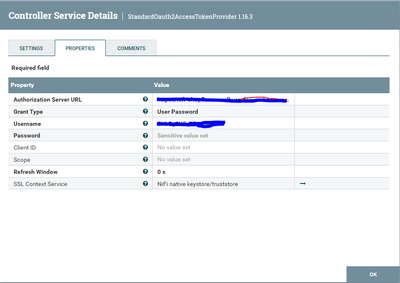

So I defined a controller service OAuth2AccessTokenProvider to generate access tokens.
From next defined API endpoint, I want to get the proprieties of a NIFI processor by its ID
https://nifi.company.com/nifi-api/processors/ae91429e-es3a-1eq9-fe53-b13680cff1e5
I used for that the InvokeHTTP processor with a GET HTTP method and by linking the OAuth2 Access Token provider field to the previously defined OAuth2AccessTokenProvider controller service.
But I am getting such error
InvokeHTTP Failed to properly initialize Processor. If still scheduled to run, NiFi will attempt to initialize and run the Processor again after the 'Administrative Yield Duration' has elapsed. Failure is due to java.io.UncheckedIOException: OAuth2 access token request failed: java.io.UncheckedIOException: OAuth2 access token request failed
- Caused by: com.fasterxml.jackson.core.JsonParseException: Unrecognized token 'utzcnd154ffd54gedg6g5fd6gdfg656556gdg5gdgt54894455444454fsdf45fd': was expecting (JSON String, Number, Array, Object or token 'null', 'true' or 'false')
at [Source: (String)"utzcnd154ffd54gedg6g5fd6gdfg656556gdg5gdgt54894455444454fsdf45fd"[truncated 548 chars]; line: 1, column: 81]
I changed the real Token value with a random series of characters.

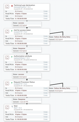

But here I will explain you how it could be possible. I created a pipeline composed of theses processors:

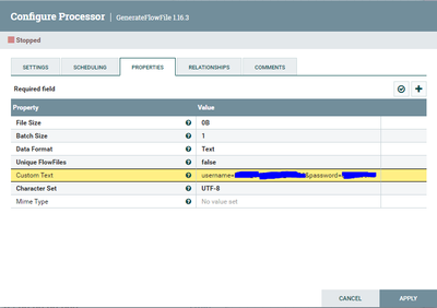

1- GenerateFlowFile: Create FlowFile with username and password of the technical user

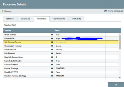

2- InvokeHTTP: Ask for an access token from the token API endpoint

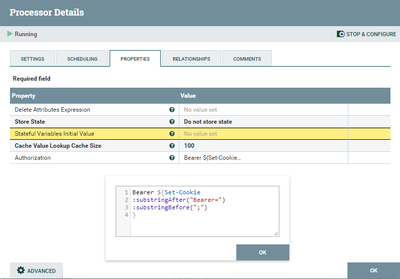

3- UpdateAttribute: Format the token and save it as ‘Authorization’ attribute

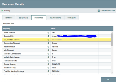

4- InvokeHTTP: Use this attribute for a HTTP request.
Here is every processor properties:
1- GenerateFlowFile: Technical user declaration
2- InvokeHTTP: Ask for access token
3- UpdateAttribute: Authorization attribute
4- InvokeHTTP: Request Processor Status

That is why I tried to use the StandardOauth2AccessTokenProvider controller service.. Who should be responsible of fetching access token and attach it to the header of the InvokeHTTP processor request. But unfortunately I am getting the previous described error.
