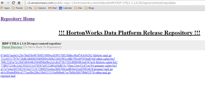

After checking on HortonWork's repo, I found that the requested file (7fd58b2be8c4f83dc8fa527736863d1aa4999069909489b3cf49f91ddd0b02dc-primary.sqlite.bz2) does not exist as shown in screenshot below.
Base URL for repo defined in HDP-UTILS.repo is http://public-repo-1.hortonworks.com/HDP-UTILS-1.1.0.20/repos/centos6, which is correct.
