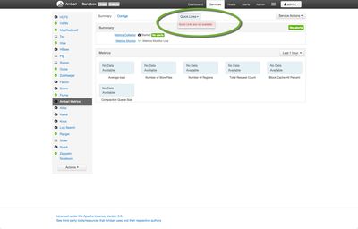

The link is unavailable on hdp 2.5 sandbox. Any ideas why? What port is the dashboard available on so I can hit the url directly instead of going from ambari... Possible?

Grafana is not yet installed on HDP2.5 technical preview. It will be installed and tested very soon. @rmolina, please check out this.
