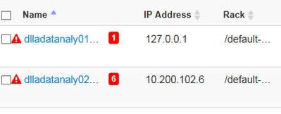

Are the IP addresses correct from the Ambari Web UI (I have posted an image in a comment below)?
New Member
Are these IP addresses correct from the Ambari Web UI?
