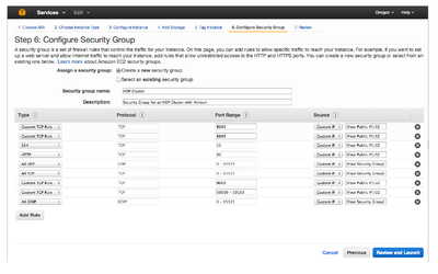

Maybe your security group is preventing your node from connecting connect back to the Ambari Server.
Log onto one of the other nodes and try telnet back to the Ambari server on port 8670.
Here is an example of a simple configuration to allow the internal ports to be open to each other.
"You will obviously need to replace “[Your Public IP]/32” with your IP address and subnet mask you wish to access the cluster from. In this example the /32 denotes a single host that we will access the cluster from. Also replace “[Your Security Group]” with the id of your actual security group. You will notice that for brevity sake we have just opened all ports internally to the security group. They are not accessible to the outside world but only between the nodes in the cluster. In a production environment you would probably want to be very specific with regards to the ports opened internally as well."
See also this blog Deploying Hadoop Cluster Amazon ec2 Hortonworks
See also the answers to this question: Looking for Steps to Install HDP on AWS

Thank you all for prompt replies and extra thanks to @Ancil McBarnett your answer was toward the right direction. I enabled all traffic in my security group (for testing purposes) as opposed to only tcp traffic before. As seen in the above logs the right port for ambari-server is 8440. That resolved the issue and now agents can be registered through Ambari.
Just in sake of completeness my setup is:
OS: RHEL-7.2 Ambari: 2.1.2 JDK: 1.8 Python: 2.7
