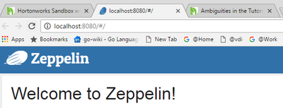

However, there is only one link provided in the Ambari quick link and it takes me to Zeppelin.
When I go thru the steps using "ifconfig" to find my host address (which happened to be 172.17.0.2) and then open in my browser that address with 8080 appended, it just times out. Should this be different than "localhost:8080"? But as noted this link takes me to Zeppelin welcome page, not Ambari.

Explorer
@Satish Bomma apparently the sandbox is configured differently (or the docker and VM are getting confused). See snippet

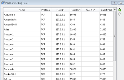

Can you confirm that your port forwarding rules are in place within VirtualBox? Here is what I see:

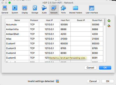

Explorer
@Michael Young mine look similar:
