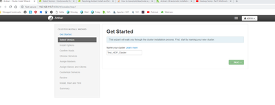

I got an Ambari Server to run, but when I try to create a cluster by its cluster name, it gets stuck on this step. Any help diagnosing the problem?

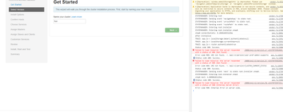

Can you refresh the page and try again? right click and see if there is any Javascript errors?

Thank you for that; there are some Javascript errors:
I'll look into getting these errors resolved; I've received one 404 error and a 500 one. Do you know the best place to get started in solving these issues?
