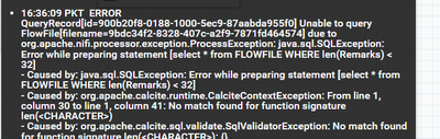

Hi @mkohs,
I am using QueryRecord processor and using SQL len function in the select statement. However, the processor results with the below error: "No match found for function signature len(CHARACTER)"
Is this the processor specific error because the same sql statement in running fine in sql server.
Any help would be appreciated.
Hi,
Nifi QueryRecord uses Apache Calcite SQL. Per the documentation (https://calcite.apache.org/docs/reference.html ) you can use either CHAR_LENGTH or CHARACTER_LENGTH to get the string size. Both functions seem to have the same behavior according to the documentation.
If you find this helpful please accept solution.
Thanks
Rising Star
This worked. Thanks.
