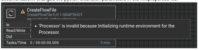

I am using NiFi 2.0 that supports python scripts directly from a working directory, after I add my custom processor to the canvas, an error "Processor invalid because initializing runtime environment for the processor" is indicated in each custom processor. I have already installed Java JDK 21, python 3.11 and all the requirements specified in the official documentation. How can I resolve this?
I have already installed Java JDK 21, python 3.11 and all the requirements specified in the official documentation.I changed the python extension parameters in the nifi.properties file.

I have been running into similar issues in recent weeks building custom processors, I have yet to find a satisfactory solution to this issue outside of removing the processors from the python/extensions folder, restarting, and then adding them back one by one.
Sometimes this will clear the issue, sometimes it won't.
Is this a known issue with Nifi 2.0, and is there any workaround or fix that the team is aware of?

i had the same issue
i made sudo apt install python3-venv
restarted apache nifi
and it worked
