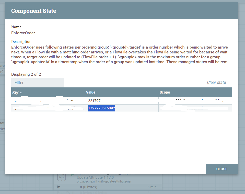

I am using the EnforceOrder in order to sort the flow files. This procesosr is maintaning state and i want to clear in it some regular interval for e.g. 4 min. I am runnig NIFI over a cluster. I am clearing the state through Inactive Timeout propery by setting it 4 min. I can see some time state is clear and most of the time not. Please help in a resolution for how clear state consistently.

The EnforceOrder processor maintain state locally specific to each node in the cluster.  When you right click on the processor an view state, you are seeing the reported retained local state form each node.  The purge of state will only happen on a specific node where the criteria necessary for purge has been met.
Might be helpful to share your processor configuration here including properties and scheduling.

Hi @MattWho
Here is the configuration attached. I am setting Inactive Timeout as 2 min. Though after 10 min still the view state is not clear. Please refer to both screenshots. Flow is as below
ListFile-->UpdateAttribute for Order attribute-->EnforceOrder--> Further processing through other processor
If I send the same file again after Inactive Timeout then as the view state does not get clear it moves to the Skipped queue.
What I see as an observation is that if I send the flow file again after Inactive Timeout then the flowfile goes to the Skipped queue and at the same time the state gets clear. So, I need to do some special handling. please suggest
