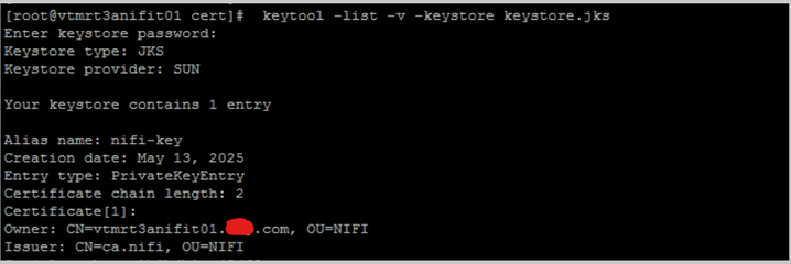

I set up a 4-node NiFi cluster and generated certificates. When I try to log in using my certificate user nifi_admin, I get the error:
"An unexpected error has occurred. Please check the logs for additional details."
When I checked the logs, I saw that the nodes in the cluster were encountering the following errors when trying to connect to the coordinator node:
The node I connect to the interface:  https://vtmrt3anifit01.x.com:8443/nifi/
The error received in the nifi-user.log file on this machine is as follows:

nifi_admin.p12
vtmrt3anifit01.x.com  keystore.jks
