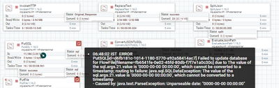

I still have 1more problem
some datetime is this 0000-00-00 00:00:00 & SQL is not accepting this data
I'll opened this issue as new post please check it
