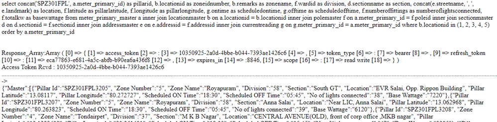

select concat SPZ301FPL , a meter primary id as pillarid, b locationid as zoneidnumber, b remarks as zonename, f wardid as division, d sectionname as section, concat e streetname, , , e landmark as location, f latitude as pillarlatitude, f longitude as pillarlongitude, g ontime as scheduledontime, g offtime as scheduledofftime, f numberoffittings as numberoflightsconnected, f totalkw as basewattage from meter primary master a inner join locationmaster b on a locationid b locationid inner join polemaster f on a meter primary id f poleid inner join sectionmaster d on d sectionid f sectionid inner join addressmaster e on e addressid f addressid inner join currentreading g on g meter primary id a meter primary id where b locationid in 1, 2, 3, 4, 5 order by a meter primary id br br br Response Array:Array 0 { 1 access token 2 : 3 10350925 2a0d 4bbe b044 7393ae1426c6 4 , 5 token type 6 : 7 bearer 8 , 9 refresh token 10 : 11 eca77863 e681 4a5c abfb b90ea6a436f8 12 , 13 expires in 14 :9348, 15 scope 16 : 17 read write 18 } br Access Token Rcvd : 10350925 2a0d 4bbe b044 7393ae1426c6 br Procesing br {"Master": {"Pillar Id":"SPZ301FPL3205", "Zone Number":"5", "Zone Name":"Royapuram", "Division":"58", "Section":"South GT", "Location":"EVR Salai, Opp Rippon Building", "Pillar Latitude":"13 08117", "Pillar Longitude":"80 272727", "Scheduled ON Time":"18:30", "Scheduled OFF Time":"05:45", "No of lights connected":"38", "Base Wattage":"7220"},
I have api that gives the above content want only the Braces value & delete rest
please help
hope Im clear
Tried - EvaluateJSONPath error - not a valid JSON Content

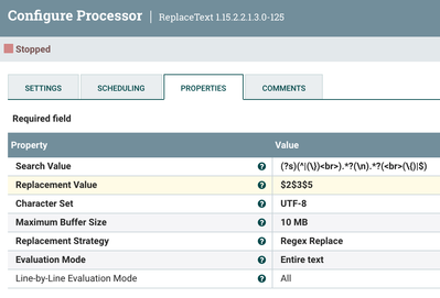

@J0sh ,
If you use a ReplaceText with the following settings it will clean up the garbage in your flowfiles:
Search Value:      (?s)(^|(\})<br>).*?(\n).*?(<br>(\{)|$)
Replacement Value: $2$3$5
This file, though, has not 1 JSON, but 8 different JSON fragments. So the resulting flowfile will still have 8 lines, each with a valid JSON. You must use a SplitText process to separate those into 8 different flowfiles before applying the EvaluateJSONPath.

Super Guru
@J0sh
You can use a ReplaceText processor with the following properties:
Search Value:      (?s)^.*?(\{".*\}).*$
Replacement Value: $1

@araujo As Im not able to attach I'll share the maximum content I can that will make it clear to understand what I have
first few lines
<br> Response_Array:Array
[0] => {

<br>Access Token Rcvd : 81e77e95-b3c2-4b0d-bf45-150caefa0250<br><br><br> <b>ZONE 1 - Loop Completed </b> <br>Procesing -> <br>{"Instant":[{"Pillar Id":"SPZ301FPL5207", "Last communicated time":"2022-04-21 14:04:58", "Volt_R":"208.40", "Volt_Y":"218.00", "Volt_B":"209.90", "Curr_R":"0.00", "Curr_Y":"0.00", "Curr_B":"0.00", "Curr_N":"0.00", "Pwr_R":"0.00", "Pwr_Y":"0.00", "Pwr_B":"0.00", "Total Load":"0", "PF_Avg":"0.999", "Total Energy Consumed (kWh)":"5106.69", "Burning %":"0.00", "Relay_R":"OFF", "Relay_Y":"OFF", "Relay_B":"OFF", "Mode":"Auto", "Load ON Hours":"0000-00-00 00:00:00", "Alerts":"", "Root Cause":""},

This is my content I think my API is mixed with JSON & xml format
sorry Im beginner & Im trying understand and learn my way up on this tool

earlier I shared information from Master flowFlile
now I sent from Instant & only the few few lines changes in master & instant API data
select concat('SPZ301FPL', a.meter_primary_id) as pillarid, g.created_date as last_communicated_time, g.vr, g.vy, g.vb, g.ir, g.iy, g.ib, g.ineutral, g.kwr, g.kwy, g.kwb, g.avgpf, g.relay_r, g.relay_y, g.relay_b, g.automanual, g.loadonhour, '' as alerts, '' as rootcause from meter_primary_master a inner join locationmaster b on a.locationid = b.locationid inner join polemaster f on a.meter_primary_id = f.poleid inner join sectionmaster d on d.sectionid = f.sectionid inner join addressmaster e on e.addressid = f.addressid inner join currentreading g on g.meter_primary_id = a.meter_primary_id where b.locationid in (1, 2, 3, 4, 5) order by a.meter_primary_id limit 5
Response_Array:Array ( [0] => { [1] => access_token [2] => : [3] => 5bc16e44-4e4c-4b21-b15c-68c4eda466a2 [4] => , [5] => token_type [6] => : [7] => bearer [8] => , [9] => refresh_token [10] => : [11] => 9654dc77-4457-49ef-ab75-f027e1a8bd22 [12] => , [13] => expires_in [14] => :8200, [15] => scope [16] => : [17] => read write [18] => } )
Access Token Rcvd : 5bc16e44-4e4c-4b21-b15c-68c4eda466a2
.....Procesing ->
{"Master":[{"Pillar Id":"SPZ301FPL3205", "Last communicated time":"2022-04-21 15:24:43", "Volt_R":"223.30", "Volt_Y":"220.20", "Volt_B":"215.20", "Curr_R":"0.00", "Curr_Y":"0.00", "Curr_B":"0.00", "Pwr_R":"0.00", "Pwr_Y":"0.00", "Pwr_B":"0.00", "PF_Avg":"0.999", "Burning %":"0.00", "Relay_R":"OFF", "Relay_Y":"OFF", "Relay_B":"OFF", "automanual":"0", "Load ON Hours":"0000-00-00 00:00:00", "Alerts":"", "Root Cause":""},
