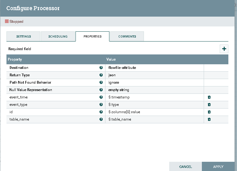

then I'm using EvaluateJsonPath Processor to add attributes like event_type,timestamp,table_name,value of column name id

@TimothySpann I've added attributes using EvaluateJsonPath.
