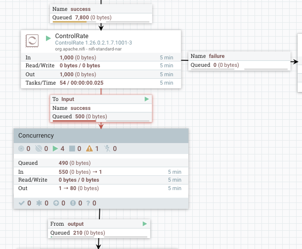

C) Combination of both A and B ListSFTP feeds a ControlRate processor (configure to allows 500 FlowFiles per minute) that lets batches of 500 FlowFiles to move from ListSFTP connection queue to connection queue connecting to a Child Process group.  Configure the backpressure threshold on the connection feeding the child PG to 500 also so Backpressure gets applied as soon as controlRate allows a batch through.  This backpressure will prevent ControlRate from getting scheduled again until this queued batch gets consumed by the child process group.  On this child process group you also configured "FlowFile Concurrency" except configured with "Single Batch Per Node" which will allow this Process group to consume all FlowFiles from the inbound connection at once.  It will then not consume again from the inbound connection until All FlowFiles are empty from the child process group.  This design method control size of batches being processed at one time in the child process group while still allowing concurrent execute of multiple FlowFiles by processor components within the child process group.
Option C dataflow would look something like this:
Here you can see no more then 500 being processed in the child Process Group at one time.  Back pressure of 500 on the connection feeding the Child Process group is set at 500 preventing ControlRate from adding another 500 to that connection until it is emptied when the Child process group accepts the next batch only happens when FlowFile count inside child process groups hits 0.  Inside the process group is where you build yoru dataflow to fetchSFTP and process however you need the batches of FlowFiles.
