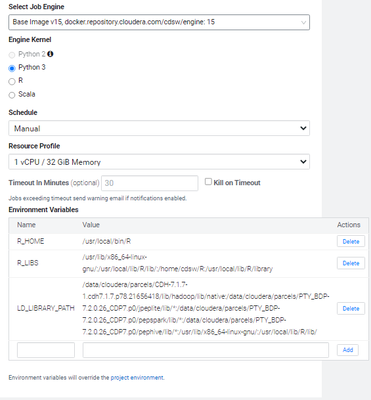

I am getting the following error on Importing R globalenv module with Python3, other modules are importing fine.

for key in os.environ:
    if key in ['R_LIBS', 'LD_LIBRARY_PATH', 'R_HOME']:
        print(key, '=>', os.environ[key])
LD_LIBRARY_PATH => /data/cloudera/parcels/CDH-7.1.7-1.cdh7.1.7.p78.21656418/lib/hadoop/lib/native:/data/cloudera/parcels/PTY_BDP-7.2.0.26_CDP7.p0/jpeplite/lib/*:/data/cloudera/parcels/PTY_BDP-7.2.0.26_CDP7.p0/pepspark/lib/*:/data/cloudera/parcels/PTY_BDP-7.2.0.26_CDP7.p0/pephive/lib/*:/usr/lib/x86_64-linux-gnu/:/usr/local/lib/R/lib/
R_LIBS => /usr/lib/x86_64-linux-gnu/:/usr/local/lib/R/lib/:/home/cdsw/R:/usr/local/lib/R/library
R_HOME => /usr/local/bin/R

Configurations used:
These Environment variables are important cannot change that,
I have tried running the code from CDSW sessions and even through python shell of my docker container that works fine.

My job Engine is : Base Image v15 , docker repository engine:15
Don't have Admin rights so reinstalling R and other stuff is not possible.

R_HOME was not setup properly, I set the environment variable to /usr/local/lib/R and that solved the problem.
