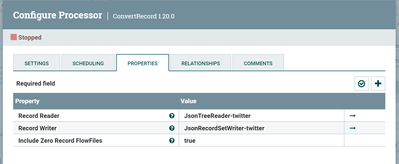

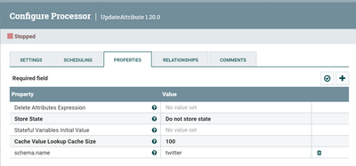

And then, I'm trying to convert flowfile into JSON with my defined schema, so I used UpdateAtribute so my flowfile has my schema name of atribute.
Then I used ConvertRecord so each record is using the same avro schema (Because the data retrieved from elasticsearch has different columns, there are field that are contained in a data and some are not) here's the configuration:

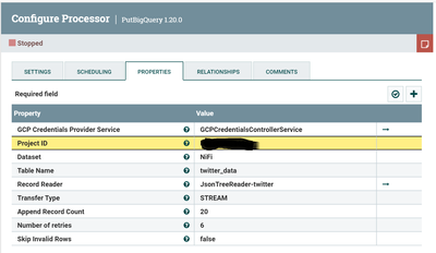

The final processor in this flow is PutBigquery:

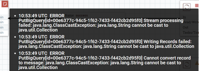

And when I run this processor it raised an error with this message:
and when I run this processor it raised an error with this message:
What do you guys think is incorrect about this entire process?
