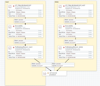

can someone help me to find solution for execute plsql oracle procedure after I finish putin record in my table in database. I have flow like this
and when all job is done I have to execute procedure with max and min ID from this flow...

Now, I have two separate flow files (one for insert and one for delete) which works fine. And in the end I put Output port.
After that job is done, I need to execute plsql procedure from destination database, so I made another process group with input port and another flow

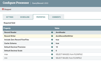

Query record processor look like this

because in last que i get two separate flow files one with min value and one with max....I think that is problem.... and I need one with two values that i can pass to plsql procedure
Excellent progress.  Can you try doing a single select to get both values?
Like this:  SELECT MAX(ID),MIN(ID) FROM FLOWFILE
If you could do that, then you could extract those values into 2 separate attributes, then feed that flowfile to the next processor in the flow.  Another alternative is to extractText for each value to an attribute, then MERGE 2 flowfiles into 1.
