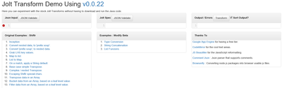

@jfrazee
when I tried to look at these examples , its not showing any JSON or specs. All I get is empty screen like this..
when I tried this link below
http://jolt-demo.appspot.com/#bucketToPrefixSoup

Master Guru
If you click on any of the examples,it should fill in the Input and Spec boxes.
Super Collaborator
@Matt Burgess
i tried to do that , but it is not filling in the Input or Specs.
