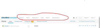

I am using CM5.16 and using custom repositories but my issue is I am  not able to see the  Backup menu which is usually on the toolbar. Do i have to enable it?demo cm.png

Expert Contributor
Do you mean BDR? If so:
- do you have a license applied to the CM UI?
- Are you logged in as an administrator?
Frequent Visitor
Hi Elias, Thanks for the suggestion. It got solved, just had to select the 60 day free trial version at initial startup as I am using it for training.
