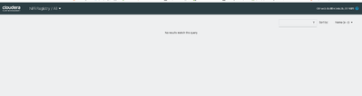

Hello,
I am working with cloudera flow manager version 1.0.1. I cannot got login page when i enable ssl & ldap in nifi registry instead of this page, and there is an node identity. I have checked the config that may be correctly. and try more time such as remove /var/lib/nifiregister/* or /var/run/cloudera-scm-agent/process/***-nifiregistry-NIFI_REGISTRY_SERVER/*
the blow pic shows the login user is node id.
the related ldap info is below, but there is not userDN config option in cloudera manager. there is same setting between nifi and nifi registry.

A couple observation based on provided information:
1. You have need clientAuth enabled
nifi.registry.security.needClientAuth=true
With this enabled in NiFi-Registry the only authentication method supported will be 2-way TLS. If you want to support other authentication methods lik Spnego, LDAP, and/or kerberos, this property must be false.
2. Your users.xml (used for user authorization and not authentication) only contains one user. I am assuming the user is :
CN=arch-fndtf04.beta1.fn, OU=NIFI
And your authorizations.xml also show that this is the only user that has been authorized to a bunch of policies. Your ldap user you want to authorize must exist in the users.xml file. My guess here is that you did not set the "Initial admin" user in your authorizers.xml (which you did not share). There are two possible providers in the authorizers were you can set the initial admin (file-user-group-provider - Only set here if your initial admin user is NOT coming from the ldap-user-group-provider. file-access-provider - initial admin must be set here so initial admin policies are created for this user.
3. The users.xml and authorizations.xml files are only generated if they do not already exist. If you go back and add an initial admin to your authorizers.xml, you will need to delete/rename the existing users.xml and authorizations.xml files o new ones can be generated in startup.
4. Since need clientAuth was set to true and UI clearly shows that user string:
successfully authenticated, your browser must have this client certificate loaded and presented to the server when you navigated to the URL for your NiFi-Registry. I really see no reason why this certificate was loaded int to your browser. NiFi-Registry, even when need clientAuth is false, will always try mutual TLS authentication first (becomes a WANT instead of REQUIRE when need clientAuth is false). If no client certificate is provided in TLS handshake, next auth method tried is Spnego (if configured), and finally a configured login provider from the identity-providers.xml.
Hope this info helps with correcting your setup issues.

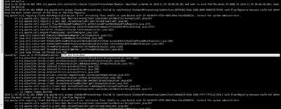

I was in no way implying that you should have removed your NiFi nodes DN as a user identity in the NiFi-Registry. The DN for every NiFi node must exist in NiFi-Registry and have been granted both proxy and read on "Can Manage Buckets" policies.
NiFi nodes will regularly read the buckets in the NiFi-Registry to see if a newer version of your Version controlled PG exists (this is why read on "Can manage buckets" is needed.). The "?" is displayed when the NiFi nodes can not read the bucket.
When a user in NiFi performs a version control action, the node will proxy the request n behalf of that user to the NiFi-Registry. This is why all NiFi nodes must exist as users in NiFi-Registry and have the proxy policy granted to them.
Only your initial admin user should have all policies except proxy. That user should never be proxying anything.

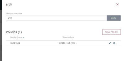

Thanks for your detail answers. I almost to get win.
Unfortunately, I can not get sync policy between NIFI and NIFI Registry with my ldap account. I must to config my node identity as a user like CN=arch-fndtf04.beta1.fn, OU=NIFI and grant it proxy access policy, so can import the bucket and commit the version. If i remove the user CN=arch-fndtf04.beta1.fn, OU=NIFI or i remove the proxy access policy of it in NIFI Registry. The NIFI GUI will show the "?" on top left corner of process group picture.
Could you help me how to avoid the issue?
Paul
Thanks,
