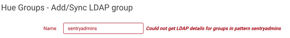

Assuming that I already had (OS & Hue) group "sentryadmins", then I am getting error on "Add/Sync LDAP group":
But, if I first delete the Hue group "sentryadmins", then the sync functionality works. Any idea for this?
It is supposed that sync will sync existing groups (my case) or add any new ones.

Rising Star
Hello @bgooley
This is the error when syncing an existing group:
views    WARNING  There was a naming conflict while importing group sentryadmins in pattern sentryadmins
 and more specifically, this line of useradmin/views.py
group, created = Group.objects.get_or_create(name=ldap_info['name'])
 returns
group=sentryadmins
created=False
So, I can tell that the group is not created at Django level when it already exists. Looking closer in the python code, there is a comment:
# This is a Hue group, and shouldn't be overwritten
which is right! The group already exists, should not be overwritten, but users should become members of the group during sync, which is not happening.
