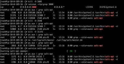

I think I have found the issue. The debug: True is set in /etc/salt/master.d/custom.conf
rest_cherrypy:
  port: 3080
  debug: True
Because of this flag the salt-api prints out more useful info for debugging, but it has the side effect that it will reload itself when the underlying code is changed: https://docs.saltstack.com/en/latest/ref/netapi/all/salt.netapi.rest_cherrypy.html
I saw the "Restarting because ..." messages in the Salt master log while the Ambari was installing the packages for HDP (e.g. in my case the email/mime/__init__.py was touched and triggered the restart, which was not handled very gracefully by cherrypy and caused the port collision.
2016-10-21 21:25:30,016 [cherrypy.error                           ][INFO    ][3454] [21/Oct/2016:21:25:30] ENGINE Restarting because /usr/lib64/python2.6/email/mime/__init__.py changed.
2016-10-21 21:25:30,016 [cherrypy.error                           ][INFO    ][3454] [21/Oct/2016:21:25:30] ENGINE Stopped thread 'Autoreloader'.
2016-10-21 21:25:30,017 [cherrypy.error                           ][INFO    ][3454] [21/Oct/2016:21:25:30] ENGINE Bus STOPPING
2016-10-21 21:25:30,027 [cherrypy.error                           ][INFO    ][3454] [21/Oct/2016:21:25:30] ENGINE HTTP Server cherrypy._cpwsgi_server.CPWSGIServer(('0.0.0.0', 3080)) shut down
2
I was thinking about a workaround, but I was not able to figure out any what you can apply. I will try to make a fix for it.
Attila

This is the process listening on 3080
root      9513  3610  0 16:52 ?        00:00:02 /usr/bin/python2.6 /usr/bin/salt-api -d
I tried killing this process but it just get recreated. I think this is the problem, just not sure how to address it.

Hi @Vadim Vaks, Is this error reproducible? Or was a single failure? If it is reproducible then could you send us the blueprint, please?
The salt-api should use the port 3080, so that seems correct. Could you check that how many instances are running of the salt-api with: ps aux | grep salt-api
You can try to kill it/them with kill -9. If you kill it with -9 then it won't be restarted. You can also try to stop it with service salt-api stop.
After you have successfully stop the salt-api please move the /var/log/salt/master to e.g. /var/log/salt/master.bak and start the salt-api with service salt-api start and send us the content of the new /var/log/salt/master which will contain only the boot log of salt-api.

Screenshot of ps aux | grep salt-api and netstat to show the one listening on 3080. (during Blueprint deployment)
