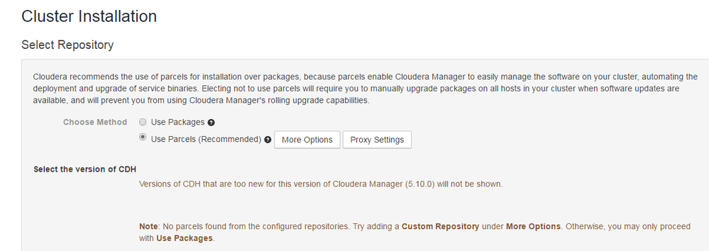

I am trying to install Cloudera Manager 5.10.0 but am unable to proceed beyond the parcel selection screen. The system does not have internet connection, so I have copied the parcel to local webserver. However the parcels are being not recognized. I have this error message.

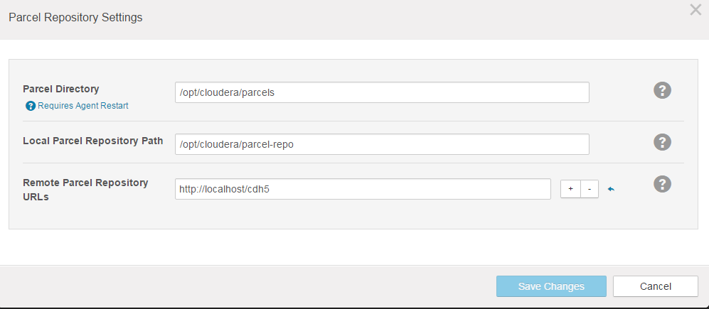

The more options screen looks as below

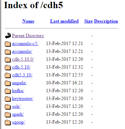

The webserver when accessed from browser shows the following
I started with cdh-5.10.0 then downloaded 5.10 but it was not recognized. Then the archive latest location was pointing to cdh5.3.10 so I downloaded that too. Still no luck. I have also tried copying everything to parcel repo directory and changing .sha1 to .sha as suggested in another post but that did not help either. Can you someone point out what I am missing? Thanks in advance.

I just noticed that you indeed your Remote Parcel Repository URL needs adjustment.
You specified:  http://loclahost/cdh
However, there are no parcels or manifest.json files in that directory.  If you want Cloudera Manager to see the parcels for CDH, you would need:
http://localhost/cdh/cdh-5.10
Make sure http://localhost/cdh/cdh-5.10 contains the parcel files and the manifest.json that goes with them.

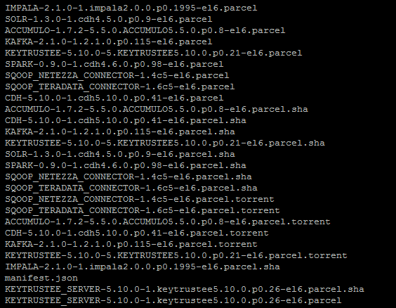

Thanks for all your replies. I tried to flatten the hierarchy I had and host it from webserver but it was still not picking it. So I copied everything to the local repository folder directly and now it picks up some of them as shown below
It does not pick up Impala, Solr, Spark, key trustee server. The local repository looks like below
The manifest.json in the directory above is the one available in http://archive.cloudera.com/cdh5/parcels/5.10.0/

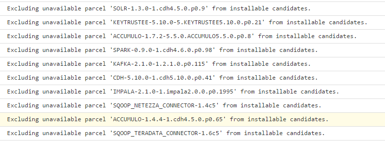

The event log from the cloudera manager shows
Excluding unavailable parcel 'SPARK-0.9.0-1.cdh4.6.0.p0.98' from installable candidates.
similarly for others. Any idea how to get these remaning parcels recognized?
