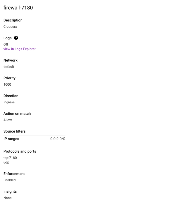

Frequent Visitor
I reset firewall rule to port tcp:7180 but still not work,
Does anyone know how to resolve the problem?
Expert Contributor
@HDPass
Could you check the below and share the output from the host where Cloudera Manager is installed:
- # curl -u <username>:<password> http://<cloudera-manager-host>:7180 -v
- # netsat -nap |grep 718
Also, share the screenshot of the error you see when trying to open the CM Web UI.
Regards,
Tarun
