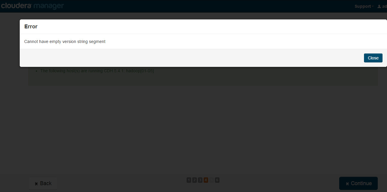

OK, so I"ve nearly completed a CDH5.3.2 Cloudera Manager Installation and when navigating to the next to last installation screen, get a lightbox error message "Cannot have empty version string segment" with only a close button...
So click the Close button and can't seem to move forward and I'm not interested in uninstalling...
so what can I do to fix this in the background??  Thanks in advance for your collective wisdom.

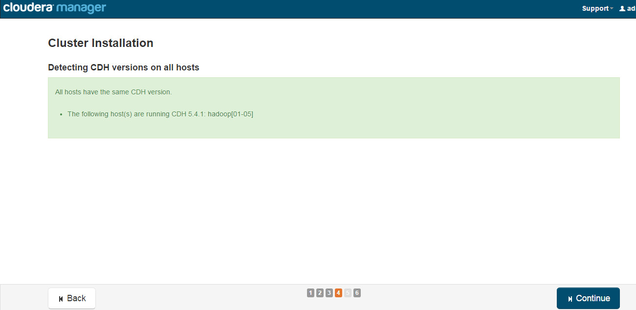

Explorer
Hi support
What version of Cloudera Manager are you running?
