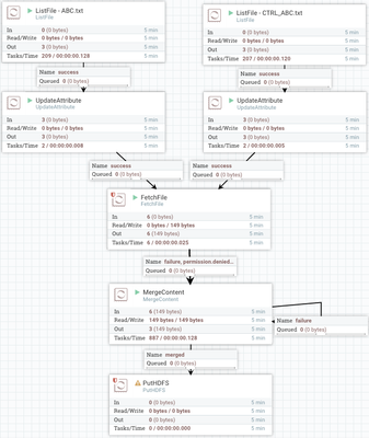

Let assume you want to merge the text based Content of both your ABC.txt and CTRL_ABC.txt files into one single NiFi FlowFile. The resulting content of that new merge FlowFile should consist of the content of CTRL_ABC.txt before ABC.txt.
A simple combination of ListFile (need 2 of these) --> UpdateAtttribute (need 2 of these) --> FetchFile --> MergeContent will do the trick.
The flow would look something like this:
A template is below that can be uploaded to your NiFi which will show how to configure each of these processors so that they are merged in the proper order and merged with the appropriate CTRL files.
merge-two-files-using-defragmentation.xml
Hope this helps,
Matt

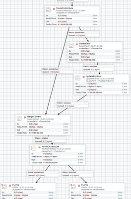

Hi @Matt Burgess, I have a question with regards to combining attributes from two different flows. I would like to merge the attributes of two different flows without merging the contents. For example, looking at the following flow:
I have different types of files and I would like to add some attributes based on the content of one type of files and then merge all attributes. I know using MergeContent I will be able to keep all unique attributes if the output of the MergeContent is set to merged. But I do not want to merge the contents of my files and would like to keep them as their original format. So, is there any way to merge the attributes of two different flows?

@Matt Burgess, just to clarify my above question, I need to get some values from 1.ctl and use these values as attributes for 2.txt.
GetFile>RouteOnAttribute(filename)>(if filename ends with ctl then: extractText>UpdateAttribute)
How can I add these attributes to the attributes of 2.txt?
I really appreciate your help.
Created 03-07-2018 03:05 PM
- Mark as New
- Bookmark
- Subscribe
- Mute
- Subscribe to RSS Feed
- Permalink
Will it always be the same ctl file? If so then you could use LookupAttribute to add attributes from the ctl file based on some key (like ID). Alternatively, you could read in a ctl file, extract the values to attributes, then set the filename attribute to 2.txt and use FetchFile to get 2.txt into the flow file's content (and the ctl attributes should remain in the flow file).
Selective merging is IMO not a "natural" operation in a flow-based paradigm. It can be accomplished with something like ExecuteScript, but hopefully one of the above options would work better for your use case.
