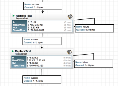

You should be able to simply use two ReplaceText processors in series to create the XML structure you are looking for:

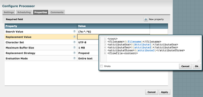

First replace text configured to prepend text to the binary content as follows:

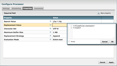

and the second to append text to the resulting content from the above:

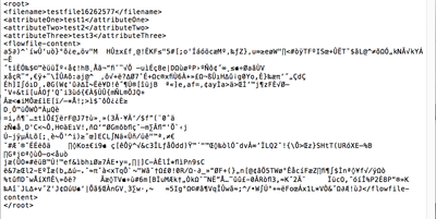

*** Note: if you hold shift key while hitting enter, you will create a new line in the text editor as shown in the above examples. An example of the output from the above would look like this:
There you have the binary content between <flowfile-content> and </flowfile-content>
