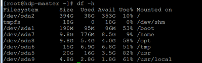

But the cluster is not taking much space. I am aware of the fact that it will reserve some space for non-dfs use.But,it is taking uneven capacity for each slave node. Is there a way to reconfigure hdfs ?
PFA.
Even though all the nodes have same hard disk, only slave 4 is taking 431GB, remaining all nodes are utilizing very small space. Is there a way to resolve this ?

@vinay kumar Whats the output of df -h in slave 4?
You can add /hadoop and restart HDFS and then you can remove other mounts from the settings.

@Neeraj Sabharwal
I have attached an image in my previous comment for slave-4 df -h command. So if i remove the other directories...wouldn't it effect the existing cluster in any way ?

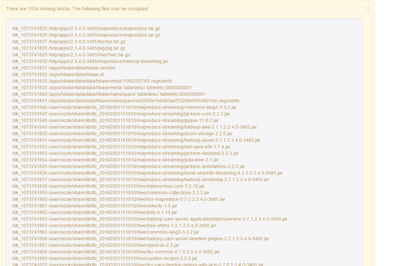

I am getting this error after removing other directories and replacing them with /hadoop . And yes,the cluster size has been increased.

I think now i got the clear picture of it. Since the mount / is partitioned with 400 GB we should use it alone to make use of that memory. But then that configuration is default configuration given by amabari. Wouldn't it affect the cluster in any way ? should i take care of anything ?
Master Mentor
@vinay kumar We allocate dedicated disks for HDFS data. We have to modify the datanode dir setting during the install.
Rising Star
@Neeraj Sabharwal
adding /hadoop and deleting other directories after some time is resulting in missing blocks. Is there any way to overcome this? When i run hdfs fsck command.Its showing that all block are missing. The reason for being could be the removal of directories. do we need to copy the data from directories into new directory(/hadoop) will that help ??

I have allocated around 400 GB for / partition. PFA.
Rising Star
Hi @vinay kumar, I think your partitioning is wrong you are not using "/" for hdfs directory. If you want use full disk capacity, you can create any folder name under "/" example /data/1 on every data node using command "#mkdir -p /data/1" and add to it dfs.datanode.data.dir. restart the hdfs service.
You should get the desired output.
