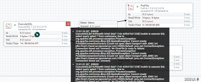

New Member
We are facing another issue regarding the hive connection pool of which screenshot is attached below and in this we are using HDF version of Nifi. Can you help with this?
