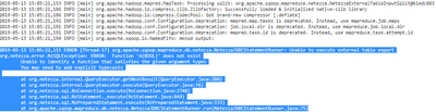

We are pulling data from a Netezza database to hive using sqoop direct option, we are providing a custom SQL it has a syntax error which makes the mapper fail, but the sqoop command doesn't fail.
2019-05-09 18:17:05,175 ERROR [Thread-17] org.apache.sqoop.mapreduce.db.netezza.NetezzaJDBCStatementRunner: Unable to execute external table export org.netezza.error.NzSQLException: ERROR:  Function 'A(BOOL)' does not exist     Unable to identify a function that satisfies the given argument types     You may need to add explicit typecasts
    at org.netezza.internal.QueryExecutor.getNextResult(QueryExecutor.java:280)     at org.netezza.internal.QueryExecutor.execute(QueryExecutor.java:76)     at org.netezza.sql.NzConnection.execute(NzConnection.java:2740)     at org.netezza.sql.NzStatement._execute(NzStatement.java:849)     at org.netezza.sql.NzPreparedStatament.execute(NzPreparedStatament.java:155)     at org.apache.sqoop.mapreduce.db.netezza.NetezzaJDBCStatementRunner.run(NetezzaJDBCStatementRunner.java:75)
