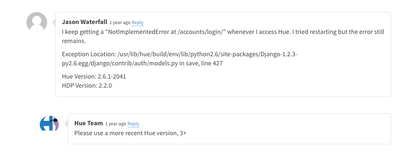

I already started Hue using the commands you sent me. However, when I try to access it through port 8000 I am having NotImplementedError as result.
NotImplementedError at /accounts/login/
Request Method: | GET |
Request URL: | http://13.92.103.143:8000/accounts/login/?next=/about/ |
Django Version: | |
Exception Type: | NotImplementedError |
Exception Value: | |
Exception Location: | /usr/lib/hue/build/env/lib/python2.6/site-packages/Django-1.2.3-py2.6.egg/django/contrib/auth/models.py in save, line 427 |
Python Executable: | /usr/bin/python2.6 |
Python Version: | |
Python Path: |

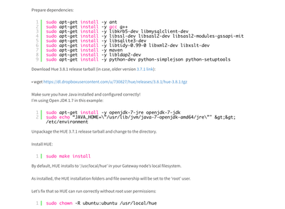

After some digging, I found http://gethue.com/how-to-deploy-hue-on-hdp/
It seems the sandbox ships with version 2.6.1 (can you verify you have 2.6.1 by viewing /usr/lib/hue/VERSION)
Can you try to http://gethue.com/hadoop-hue-3-on-hdp-installation-tutorial/
Let me know if that works
