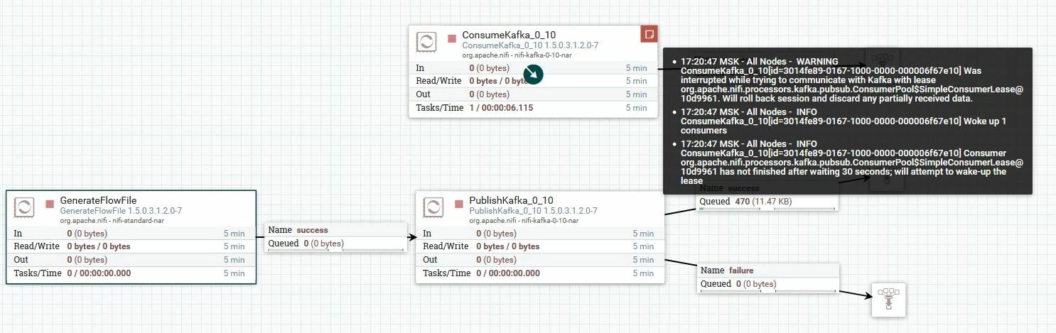

Hello,
I have enable kerberos on cluster. I can successfully connect to consumer through kafka-konsole-consumer.
But when i try to connect to topic through NiFi ConsumeKafka processor i have error:
WARN [Timer-Driven Process Thread-8] o.a.n.p.kafka.pubsub.ConsumeKafka_1_0 ConsumeKafka_1_0[id=504e5811-0168-1000-0000-000024c83cc5] Was interrupted while trying to communicate with Kafka with lease org.apache.nifi.processors.kafka.pubsub.ConsumerPool$SimpleConsumerLease@51911c24. Will roll back session and discard any partially received data. WARN [kafka-kerberos-refresh-thread-nifi/*@*] o.a.k.c.security.kerberos.KerberosLogin [Principal=nifi/*@*]: TGT renewal thread has been interrupted and will exit.

I can't connect with --bootstrap-server key, only with --zookeeper works. Obviously "ConsumeKafka processor" use "bootstrap" mod.
Can i use zookeeper with "ConsumeKafka processor" or how can i debug why i can't to connect direct to broker?
kafka-console-consumer.sh --bootstrap-server server:6667 --topic test5 --from-beginning --security-protocol SASL_PLAINTEXT
don't work
kafka-console-consumer.sh --zookeeper server:2181--topic test5 --from-beginning --security-protocol SASL_PLAINTEXT
work fine
